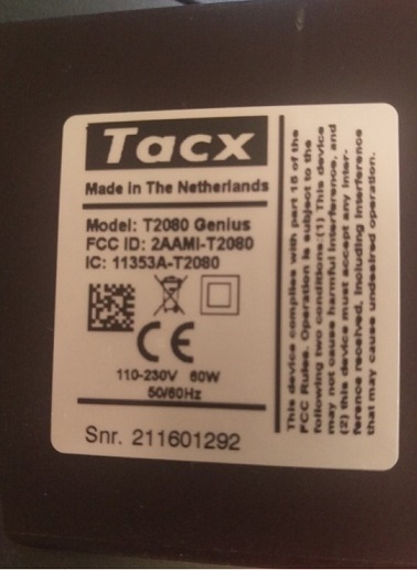

If you do not need smart features, then all is well. If you still need smart features, check this label on the electro unit:
