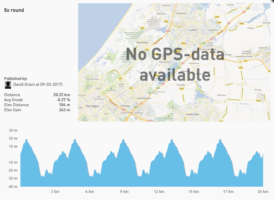

Vallegio ............Can be a little difficult but we use the coloured climbing icons for hill rep sessions........going hard on the red icon and easing up at the green one. I created a course called "5 times round"......It's one of our favorites.
Is '5 times round' on BikeNet?

sgmack
Posts: 212
Joined: Sat Jan 13, 2007 8:29 pm
Location: Essex UK
Re: TTS4 VR vs Fortius
Post by sgmack » Mon Feb 12, 2018 4:40 pm
Hi ms6073
Strange you had issues with Metropolitan. I've found the roads there virtually pan flat. We've used this course for our 4mins hard 2mins easy sessions.
Riding through the park can get a little sticky but i stay away from there.
I'll upload "5 times round" to Bikenet and let you know.
Cheers...........Steve

Posts: 1549
Post by Alex Masalovich » Mon Feb 12, 2018 5:36 pm
Is not that what you're talking about?
sgmack
Posts: 212
Location: Essex UK
Post by sgmack » Mon Feb 12, 2018 6:15 pm
Hi Alex
Many Thanks..........Yes that's the one. I couldn't remember uploading but obviously my mate David did !!!
@ ms6073.........Slight uphill start but basically you ride easy until you hit a red icon, then go as hard as possible, easing up at a green icon.
Ride easy until you hit the next red icon then go like hell......easing up at the green icon.....Repeat for 5 laps.
Five times round is basically a hill rep session. Don't forget to warm up before starting !!!
Cheers.........Steve
