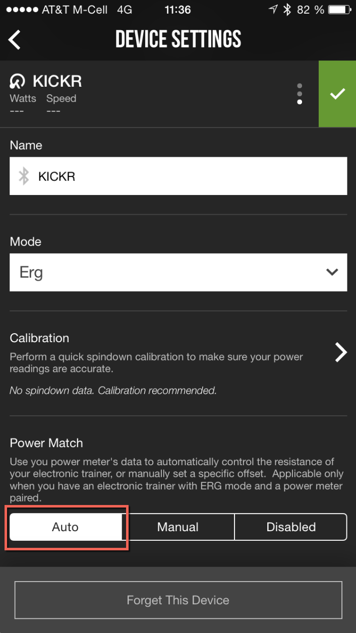

zacha wrote:This option does not exist in Trainerroad's current beta.
Sorry, you have me confused. If the feature has been deprecated, then what are these items?
iOS App:
Desktop App:
TTS 4.19.1 | T2800 NEO Smart

zacha wrote:didn't I talk about current beta version?
Apologies. Just traded some texts with Nate from TrainerRoad and PowerMatch is not yet implemented in the current Windows BETA but should be implemented by weeks end.
