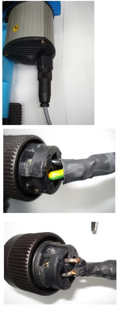

It sounds like hardware issue caused when the break has no power, if the break has power then then any software/USB/cadence issue would set the break to a easy zero grade, like when your in the menu or even before you turn on TTS (you would also get a warning to say no cadence). I would look to the big cable that goes into the silver box (adaptor) sometimes it can be bent to such an extent that the cables in side the big grey cable come loose, if you can see the cables or the shielding then it will need to be fixed, obviously check the mains power supply, sockets & if it starts to happen regular to call your distributor. I read that there is a pdf with instructions on how to fix it your self if its the loose connection & you feel confident fixing plugs etc.

try the link at bottom of this post:
After hearing these reports of loose wires, particularly on 220 volt units, I checked a 220 volt unit that I was using for testing here in the U.S. This was provided to me a couple of years when Tacx was trying to deal with the problems with the 110 volt units.
I initially reported to Tacx that the 220 volt unit worked very well and had none of the problems of the 110 volt units. However, after a few weeks, the unit started heavy braking without warning and I was no longer able to use it even though I really liked it when it worked.
Following these recent discussions mostly from 220 volt users with problems, this morning I checked the wire connections and all 4 wires were loose! 2 of them were so loose that they were falling out of the connector. It's actually a miracle it would work at all.
I'm not sure if this was just a poor assembly issue with a batch of 220 volt units or whether there is a thermal issue that causes the screws to loosen. I noticed that the ends of the wires are tinned with solder. Some connectors actually do better not tinned. My guess is it is not likely a thermal issue and is probably poor assembly.
So, I would say that anyone who is having problems of intermittent or odd braking, this is definitely worth checking. I have recommended that Tacx post the service bulletin on its website or this forum on this issue. The most important thing to do when checking this is to be sure the power is off and that the wires are in the correct places.
You can download an instruction sheet here (sorry for the pop-ups as this is a free site):
http://www.mediafire.com/file/h21nonzdnj2/information cable check T1941.50.pdf
your basically checking cable in pics below :
