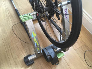

Finally got my ant+ controller working for my aging Tacx Flow. It tracks the gradients in Zwift adjusting the electromagnetic brake. I've created a new power profile which closely matches my power2max once calibrated. It gets picked up just like any other ant+ fe-c device with power meter attached. It's powered like the original controller from the trainer unit.
Pretty nifty. Some questions and comments:
1. Have you posted a complete set of instructions anywhere? There are probably a ton of Imagic/Flow trainers out there.
2. I assume that this does not transmit ANT+ speed and cadence, but that could be handled with a separate ANT+ combo speed/cadence sensor.
3. I assume you would have to do some more to get an older Fortius to work. The Fortius has a much different power profile and probably some other characteristics.
4. Is this all compatible with either a 32-bit or 64-bit W10 OS?
bug2k18
Posts: 4
Joined: Thu Nov 29, 2018 12:58 pm
Re: Antifier- Program lets Zwift or TrainerRoad control older Tacx with ANT+
Post by bug2k18 » Fri Jan 11, 2019 1:45 am
mcorn wrote:
Thu Jan 10, 2019 9:43 pm
bug2k18 wrote:
Thu Jan 10, 2019 8:44 pm
I haven't posted instructions, I'm happy to help anyone that wants to make one up. It could easily be made to transmit speed and cadence, I have connected the cadence signal pin up to the arduino but haven't written any code to handle it as I already have ant+ speed/cadence units on my bikes. I couldn't say how compatible it is with the Fortius as my controller replaces the yellow/orange Tacx computer that came with the trainer, from looking at pictures a lot of trainers from that era they seem to have visually the same braking unit. The connection to the braking unit is an analog one, with resistance being set by syncing a pwm signal with a mains frequency ac signal from the braking unit, this either reinforces the magnetic resistance or counteracts it.
It would work with any device that has an ant+ receiver, I tried it initially working as just an ant+ power meter and it was picked up fine on my Garmin.
mcorn
Posts: 8171
Joined: Fri Nov 24, 2006 8:55 pm
Location: USA, Bellingham, Washington
Post by mcorn » Fri Jan 11, 2019 2:10 am
Your orange and white Flow controller was a standalone device and was quite a bit different than the PC interface that most users had. But I am assuming that the signal characteristics needed to control the brake would be the same. The brake's cadence is simply a feed through to an external sensor triggering the opening and closing of a reed switch, so that is very simple. On speed, I am guessing there is a hall sensor measuring rotations of the spindle with speed calculated using the circumference of the spindle.
The Fortius is a very different brake. It self-motors down hills and uses motoring to simulate momentum. Not sure how the software interfaces to that function. The power curve of the Fortius is very different than the Flow. In addition, the Fortius had both 110 volt and 220 volt models whose characteristics were fairly different.
Anyway, I really do compliment you for this nice effort. I currently use a Flow Smart, but have an older Flow brake which I might like to make ANT+ compatible. Personally, I would only care about brake control and not be concerned about speed and cadence as I use separate ANT+ sensors.
P.S. How does your system calibrate the brake?
bug2k18
Posts: 4
Post by bug2k18 » Fri Jan 11, 2019 11:22 am
I would be surprised if it worked with a Fortius with a motor brake, as I can see that needing a different kind of electrical connection to the computer.
This is the trainer I have:
The imagic trainer looks to have a very similar braking mechanism:
There appears to have also been a flow which is blue in colour, no idea what might be different on that version, the resistance unit looks the same.
The calibration is a basic rundown test, with resistance set to 0, get speed over 30mph and time the rundown, this seems to work quite well unless extreme pressure is put on the tyre with the roller. The rundown time can change quite a bit until the tyre has warmed up.
Speed seems to be an optical sensor with a 4 slotted rotor that breaks the signal, there were a few quirks to getting a nice stable speed reading but works fine now, tracks the garmin speed reading well.
Having made this version there's probably quite a bit that could have been changed/improved with the interface circuit as I'm not really an electronics guy, but it works fine for my needs. I just started with a few things I already had paying around, the arduino and lcd. For someone with more time, the software could be improved, implementing more of the ant+ protocol, but for basic resistance control and setting of gradients in zwift, it works fine. I didn't see the need to send speed from this unit as virtual speed is calculated from power by whichever software is being used.
